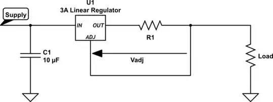

If it is a constant current source that you need, there are several ways to build one. Each one has its advantages, and the subject is very broad. Maybe if you explain your specific issue, experienced users will direct you.
One of the most common and straightforward ways to regulate the current is to use an integrated circuit like the LM350 or similar ones. Very common in hobby projects, and if you google around you can find many guides and tutorials.
Please notice that any approach you choose, since you will be now controlling the current, the voltage will become the dependent variable of your circuit, and for linear circuits Ohm's law still applies! So the voltage will still be the product between the circuit impedance Z and the current you are regulating. You are not necessarily getting a 5 V or 8 V voltage, it depends on the circuit.
(By simplifying a bit, impedance Z is the same thing as resistance R, as long as you only have DC)
sEdivad
You can find the value of R1 with ohm's law. Whit linear regulators, the current to the ADJ pin is small and can be set to 0 for your calculations.
pserra
