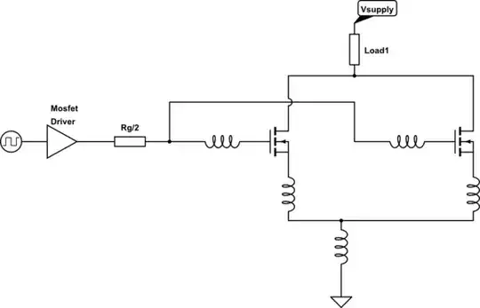

Your practical placement will create something like this (there will be a few other stray inductances but for now this will do).
If you think about the current flow when you charge/discharge the gates it will be
  1. MOSFET driver
  2. Gate resistor
  3. Split path to the MOSFET
  4. via each MOSFET source
  5. recombine at the common reference
  6. via some path back to the MOSFET driver
This loop is one you need to keep BALANCED & ideally minimised. Imagine if due to poor layout/tracking/wiring the right FET's source had 10x the inductance on the gate and/or source, it will switch slower which mean the left FET will experience more of the transient responses.

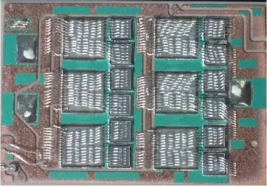

In large power devices they use a small individual gate resistor per die & then parallel all the devices up, but they keep the layout really-really tight & equally they are in control of the MOSEFET/IGBT batch characteristics for very closely matched devices . If you cannot do this then it is better to have a separate gate resistor.
Parallel IGBT die on a common substrate
The benefits of a separate gate resistor is, if you need to tune the response of one leg based upon other observations, you can
Sharing a resistor is not recommended because of variations in VGS(TH). With individual resistors, the FETs' switching will be more concurrent.
