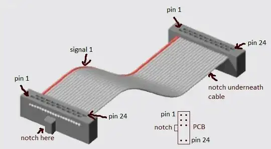

Here is how you should do. It is actually very straightforward. The PCB footprint is the same on both sides, and the numbering is the same too.
What you had wrong, probably, is that you weren't considering having the notch underneath the ribbon for one of the connector (and only one).
