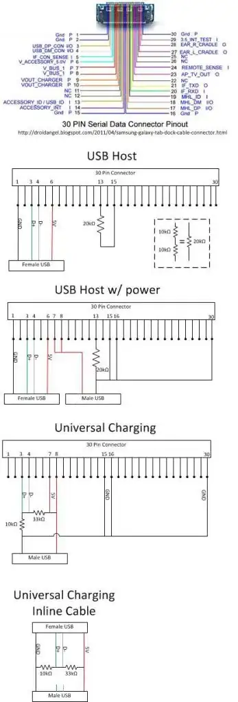

Yes this can be done - definitively!
We actually got this to work by combining the USB Universal Charging spec with the USB OTG spec. This does require a custom cable to accomplish, but it does work. We took the idea from this post and altered it into a single cable solution, whereas the post has a separate power source and data cables.
Wiring diagrams:
Post schema
