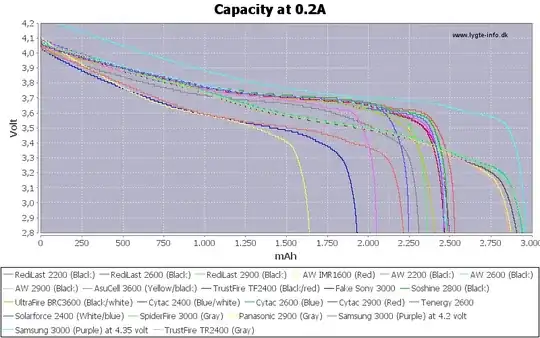

No, it's the actual capacity. Rated capacity is whatever the manufacturer decides to put on it. This figure may be wildly 'optimistic'. Reputable manufacturers rate a bit lower than typical capacity, though some discharge below 3V (knowing that the cell may suffer damage) in order to get a higher rating. Others just think of a number and double it or worse.
Here's a graph of actual capacity curves for many 18650 size Li-ion cells. Most had very little capacity left below 3.3V, and all had virtually nothing left below 3.0V.
