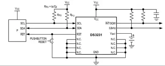

Below is my schematics for the receiver circuit. Thank you.
