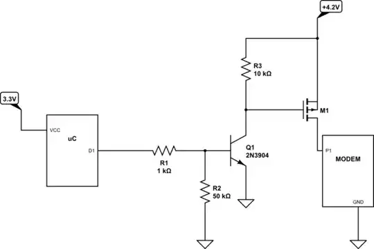

a better idea for this, if you want to use a PMOS high side switch, would be to have the ATSAMD21 switch a low-side NPN switch, which then switches the PMOS for the SIM530. Example:
R2 (arbitrarily chosen to be 50x R1) pulls Q1 to ground (off) if D1 is in high impedance state, which it may be if the uC is off. This means M1 gate is definitely pulled up to 4.2 V.
The issue with your design is we don't know exactly what is inside the microcontroller output when it is off, so we shouldn't rely on it. Also, considering even when DOUT is a "1" it is 3.3 V, which is lower than the 4.2 V driving the Modem, so M1 may be partially on. While it seems to be working for your case, it is not great practice... If the load were running off 5 or 12 V, the V(GS) of M1 could become an issue.

    +1 for providing the exact solution for controlling a P-channel mosfet (or even a pnp transistor). You stated that the output of the uC is *unknown* when it has no power to control its pins, which may have internal pull-down resistors. –  Dec 21 '17 at 22:47
  • Will this example work even if D1 is not in a "high impedance state"? I don't know what the usual state is for microcontroller outputs. – Michael Santiago Dec 21 '17 at 23:38
  • Also - will adding an NPN increase power use? – Michael Santiago Dec 21 '17 at 23:47
  • I'm probably going to go with this design, using the "MMBT3904" NPN switch (the 2N3904 isn't available on SMT) to avoid any potential issues with floating GND. – Michael Santiago Dec 22 '17 at 18:46
