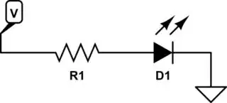

If you want to support a much wider range of behavior things get a little more complicated. Let's start by just showing the basic circuit you are talking about:
The LED diode follows the Shockley equation model pretty well, over a very wide range of behaviors. To compute the intersection of the resistor load line and the LED diode curve, let's go through the crazy math involved now.

It is also the case that the diode voltage is what's left over after the resistor drops its voltage, so recalling what I wrote earlier:
$$V_D=V - I_D\cdot R_1$$
Putting these two together gives:
$$I_{D}=I_{S}\cdot\left(e^\frac{V - I_D\cdot R_1}{n\cdot V_T}-1\right)$$
Note that \$I_D\$ is on both sides of the equation.

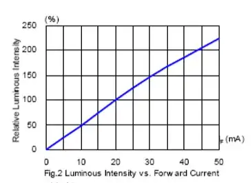

Whether the variance is tolerable is a matter of design requirements. As you can see from the typical graph below, the brightness of LEDs is fairly linear with applied current.
