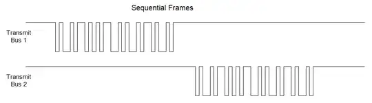

One option is sequential frames. Choose to handle one bus at a time, send a frame, if it was a query you would need to allow time for the response or timeout due to lack of response, before handling the next bus. This would probably be fast enough if you only have three buses to deal with for the lights to appear to turn on or off together. Sequential frames A better option in terms of synchronising the effects on the lights would be to send frames on multiple buses at the same time. You don't need to find a way to drive multiple MCU pins absolutely in sync to do this, just run through a list of output pin drive commands every Te (416us). The frames will only be offset from each other on the different buses by the time it takes to change the pin state. Simultaneous frames Obviously this is easy to do if the frames to be transmitted are identical, but it is not much harder to do if they are not, you just need to pick up the next pin level from two/three different variables, one for each bus. Where this would become difficult is if these forward frames were queries, because you have to try to handle multiple responses on different buses at the same time. Personally I would doubt that is possible in a single core/thread, relatively slow MCU. But you could use the sequential frames technique for queries and the simultaneous technique for commands to get the best of both worlds, if you think the added complexity is worth it for the reduced latency between buses.
