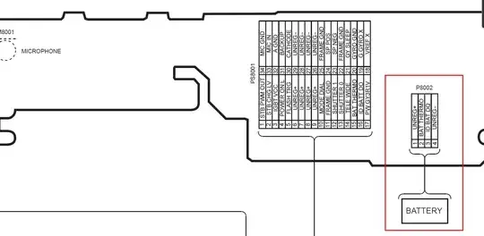

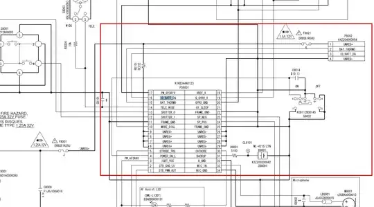

Some schematics: Service manual Schematic - panasonic_dmc-zx1_zr1 1
Service manual Schematic - panasonic_dmc-zx1_zr1 2

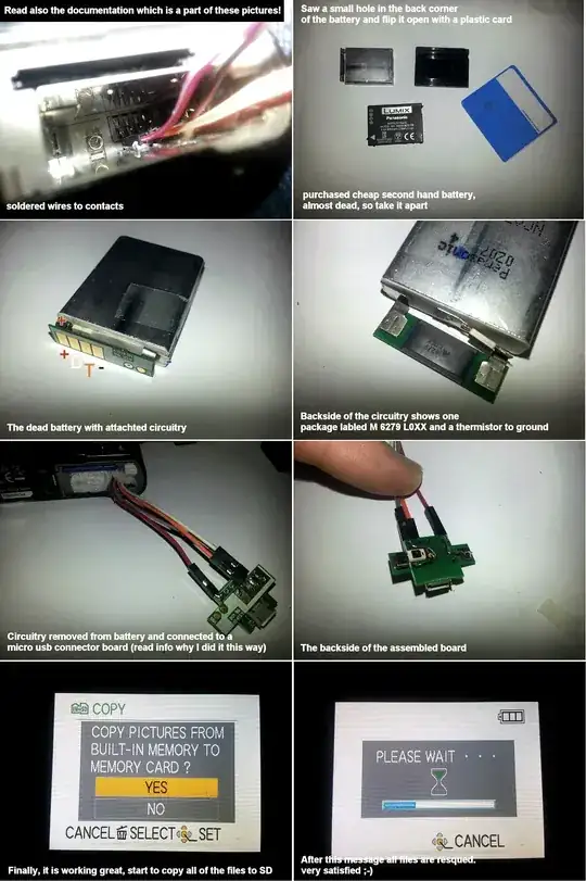

Allright, finally we done it! @KalleMP had the eye opener, however this was a slightly different battery (DMW-BLG10E instead of the DMW-BCG10E and it is fore sure another "valid and safe battery detection method"). It is not enough to fool a temperature sensor, you really need the battery IC (whatever it might be) to get it working. Also great thanks go to @SamGibson.
Purchased a cheap second hand original battery (doesn't know it will work either), just for three euro's, to use it as a donor battery, to reuse the circuitry inside this battery.
After disassembling the battery very carefully, I solder the salvaged board on a micro USB connector board for two reasons:
  • Easy and stiff connection;
  • It might be possible to use it on 5V because the camera is rated 5.1V (see experiment later on).
The first try didn't work, for some reason the board outputs only 0.7 volts when connected to a battery (3.7v). First thoughts:
  • It has something to do with smart failure detection/registration by disconnect the original battery (power disconnect = failure)
  • The circuitry was already in a failure state;
  • Heating up the board by soldering damaged the internals of the board.
By connecting the battery directly to the camera inputs and the circuitry (in fact in parallel) there was life! Now we are able to copy the data to SD-card, it works perfectly.

The schematics in the linked service manual do not include any components on the main PCB - details stop at the connectors on that PCB. However based on what is shown in the partial schematics, public info about similar battery packs and the naming conventions used for the 4 connections, my hypothesis is:
