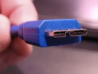

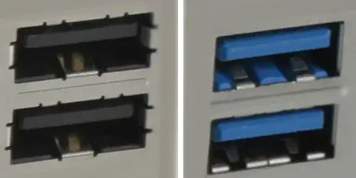

There are going to be some interesting connector issues :-):
USB2 / USB3 From here
USB3 superspeed microconnector with USB 2 backward compatability from here
USB3.COM - USB3 superspeed cable connectors from here
