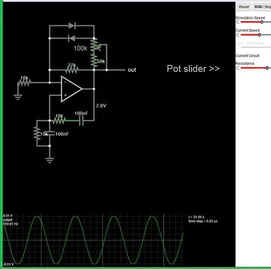

The Wein Bridge oscillator is very unstable as it is critically dependant on R tolerances. You can overcome this by increasing the gain up to 50% and adding some soft limiting. Example.
Furthermore the high Q makes the oscillator start very slow at the critical gain ratio.
Hence, it is rarely used outside the student lab. enter image description here
