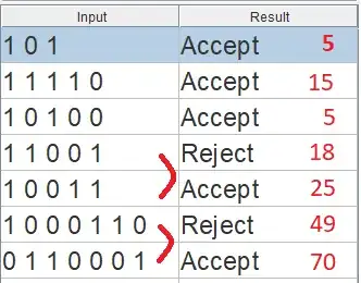

Indeed, the resulting automaton gives the right answers:
Table with two columns "Input" and "Result" listing whether various number results in "Accept" or "Reject".

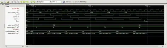

One of the things of note is the state transition table also tells us where a quotient bit would be a '1' shown by a transition to a state with a lower remainder value (or both transitions for r4) when subtracting 5 from the dividend. That can be encoded in a separate table (or a table of a record type which seems cumbersome). We do this historically in graphics hardware dealing with horizontal screen resolutions that multiples of 5 pixels.
Doing so gives us a div/mod5 producing a quotient and remainder:

Implemented here with a generate statement, an inner generate statement producing quotient bits. The remaindr array provides a state transition trace:
All without an arithmetic operation.
It's also possible to implement in a procedure without all the registers taking advantage of parameters with mode out. That'd approach a minimum number of lines for an interview.
A clocked sequential implementation would require a bit counter and flow control (a JK flip flop and a couple of gates).
There's a time/complexity trade off depending on dividend size you'd also likely be required to defend in an interview.
