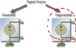

Here they define being floating as:
They mention Ungrounded = Floating.
But in another forum someone wrote:
The signal is consider floating when it does not have the same ground with your device. Earth has nothing to do with it. Earth is just another ground.

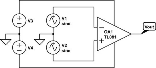

I'm a bit confused with the meaning of floating. Is the source floating in the below system?:
If it is not floating can you give an example of a system where the source ground is floating?
EDIT:
A floating source is connected to a differential amplifier. If I add a ground where the red arrow points the simulation circuit amplifies this signal very well. But if I don't use a ground the simulation corrupts.
In real do we really need a ground at that point or is this only needed in SPICE simulation? Because if I add a ground it is not floating anymore in the diagram. This is really confusing.

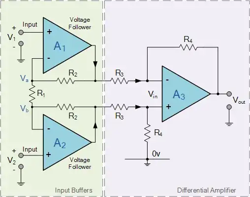

I always encounter such circuit topology for differential amplifiers:
Please notice that, above the input diff signals i.e the source and the diff. amplifier again share the same ground.

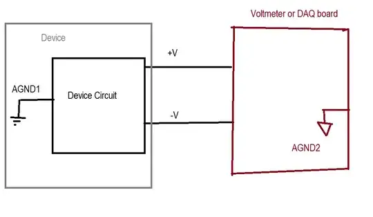

But when I look at the input terminals for a voltmeter or a diff. ended data acquisition board, there is no extra ground. There are inputs for -Vin and +Vin, but not GND.
Imagine now that I have a device which has an analog ground called AGND1 and this device has two differential outputs say 2V and -2V relative to its own AGND1. Now if I hook up its differential outputs to the voltmeter or a diff. ended DAQ board which has its own ground call it AGND2, we are facing a situation where AGND1 and AGND2 are not connected. But still these systems work as below:
As you see in a typical voltmeter or diff ended. DAQ board connection we don't connect two sytems grounds AGND1 and AGND2.
So the diff. amplifier topology I encounter uses grounds common but in real the grounds are not connected.
This is also very confusing since I dont know where my lack of knowledge comes from.

  • @Trevor Thanks, could you tell me in your "second" circuit example you said the source V1 is floating. What if that source were differential signalling, would it still be floating? Can you also give a circuit example with that, would be very glad! – user1245 Dec 15 '17 at 18:20
  • Please also see my edit where I expanded my question to a more confusing case. – user1245 Dec 15 '17 at 19:27
  • @user134429 in that instance the source is floating, but you also have no feedback around the op-amp so it is just a really bad comparator. – Trevor_G Dec 15 '17 at 19:37

I think your confusion comes from the statement Ungrounded = floating.
"Earth is indeed just a ground (reference). Imagine circuits A and B which are floating in relation to each other, they cannot share a ground (or any other connection).
If circuit A is connected to "earth" then circuit B cannot be connected to "earth" in any way. If circuit B was connected then it would not be floating anymore in relation to A.
Both circuits A and B can have a ground but they cannot share it or share any other connection.
My battery or solar powered calculator called circuit C is floating in relation to both circuit A and circuit B as it has no connections whatsoever to A nor B.
A simple trick to check if a circuit is floating is to draw a (dotted) line to separate the two circuits. The dotted line cannot cross any wires!
Like so:
Beware that a ground symbol could be used in more than one place and then it really is a connection as well although there's no visible wire.
I am unable to draw a dotted line to separate the source and amplifier in your 2nd picture. Therefore they are not floating in relation to eachother.

Confusion about this circuit:
Really, it is not that confusing!
This is only one circuit so it could float with respect to ground but does not have to. It really makes no difference as ground is just a reference point. The ground between the 2 9V batteries is a good point.
There is no need for any other ground symbols unless you want those to have a direct connection to that same ground (between the batteries).
If you add a ground to the - terminal of V1 you short it to the ground and disrupt the working of the circuit.
So no, there should be no ground added not in the simulator and also not in the real world!
But this circuit will not work well because there is no path for the base currents of the transistors. You have to set a commonmode voltage using resistors which will also supply that base current.
To solve that do this:
DC voltage source V2 must be a voltage in the common-mode range that the amplifier can handle. You can also make V2 zero and remove it.
This solution preserves the diffential nature of the signals. You could also ground (or apply a DC voltage) on one side (see Trevor's answer) and that works but then the signal is not differential anymore.

  • @user134429 You seen to think that AGND1 and AGND2 are not connected, well usually they are connected. Usually as in a **star grounding** scheme (Google: star ground to learn more). So AGND1 and AGND2 are **local grounds** and they are connected on a higher level. If they would not be connected then you can expect all sorts of problems. Your lack of knowledge comes from lack of experience, I advise you to see how things are normally done and try to understand why they are done that way. – Bimpelrekkie Dec 16 '17 at 18:43
  • @Bimpelrekkie A voltmeter has only two input terminals. Imagine a device has two diff. outputs -Vin=-1VDC and +Vin=+1VDC and this device has a circuit ground call it AGND1. And when one hooks up +Vin and -Vin to the voltmeter probes, the voltmeter will show 2VDC. And the voltmeter is a circuit and it has also a ground lets call AGND2. Now AGND1 and AGND2 are definitely not connected. Isnt it how things are normally done? Where am I wrong? – user1245 Dec 16 '17 at 19:04
  • @user134429 You should realize that "ground" is just a reference point for us, humans, or for simulators. Inside that voltmeter, the ground will be local and **only** connected to the COM input of the meter. Indeed there is no other connection. So that voltmeter is floating, if you measure between -1V and +1 V **or** +999V and +1001V, the voltmeter will show 2 V in both cases. It does not "see" that 1000V difference to ground. – Bimpelrekkie Dec 16 '17 at 21:52
  • But that differential amplifier **does** see that +1000V because it **is** grounded. It will **blow up** if you measure +999V and +1001V. That 1000V is the **common mode voltage** and all amplifiers have a limited common mode input voltage range. So a differential amplifier does not behave in the same way as a hand-held voltmeter. – Bimpelrekkie Dec 16 '17 at 21:52
  • @Bimpelrekkie I see. When grounds are shared that 1000V common mode is dangerous as you say. Voltmeter does not have this issue as you also mentioned. So can we say that the reason that differential amplifiers are used in daq systems for diff. signals with connecting source and daq analog grounds is because to reject the noise with respect to a common ground? If they were designed as how voltmeters measured, would they have problem to reject common mode noise since there is no common ground? I hope I understand what you mean. – user1245 Dec 16 '17 at 22:10
  • Yes diff. signals are indeed used to be able to suppress **common mode** disturbances and noise which can be in the ground connections but also be picked up by the signal lines. But it will be picked up the same by **both** signal lines so if we only measure the **difference** voltage then the disturbance is eliminated! Read here: https://electronics.stackexchange.com/questions/92813/how-are-differential-inputs-setup-in-a-differential-amplifier – Bimpelrekkie Dec 16 '17 at 22:21

To answer Edit 2:
While this may work. They may still be giving you a simplified diagram of what goes on in the voltmeter or DAQ. There should be some safety circuity in place to prevent extreme potential differences between devices that don't share grounds. This may be in the form of high resistance bleed off resistors or zener diodes on the DAQ or voltmeter. Without some kind of circuit protection, there's a good chance ESD would destroy the device.
The other thing to keep in mind here is that even though the devices aren't externally connected to the same ground, they are still connected between those two wires to eachother's grounds indirectly. Depending upon the transistor technology, this may be sufficient in real devices to prevent any sort of floating voltage issues.
