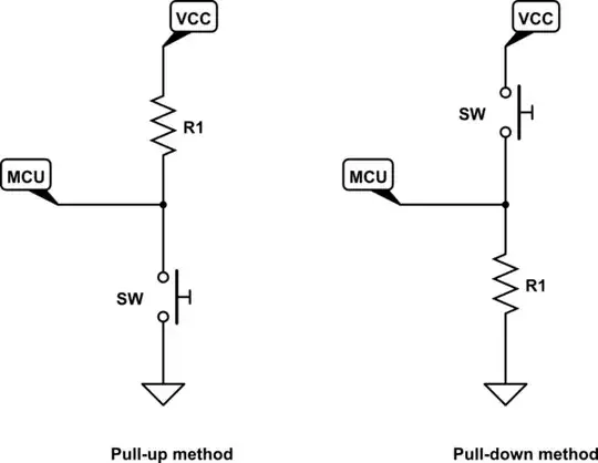

During a meeting for a particular project I was asked to think about the way to detect a push on a button with a MCU. The detection should consume as little power as possible. At the first glance, I thought the typical circuit with a pull-up or a pull-down :
I don't account for some anti-bounce features here, as that is beyond this question's scope. In either case, when the button is pushed, the total current value that flows depends on the resistor value. To minimize it (the current), I could increase the resistor value but not so much since, if I am right, it also depends on the input pin leakage value. Plus, a large resistor would recover slowly.
My question is the following one : what are the smart ways to detect a button pressed that doesn't consume power (typically for a high power consuming application)? Are there any methods that are barely power-consuming when the button is pressed?

    A pull-down of 10k consumes nearly no power. 3.3V gives 330uA. And on most modern MCUs you have the option to set one internally, which will have even higher resistance. That being said, you can activate the button supply from a MCU pin through a BJT or MOSFET. Only activate it during the read, and read with polling. – Lundin Dec 12 '17 at 15:14
    @Lundin In "modern" terms, 330 \$ \mu \$A may be a high current... – awjlogan Dec 12 '17 at 16:15
    indeed, many microcontrollers can get sleep currents as low as 2-10 μA. Wasting 30x that on a single pull-down is kind of sad, especially in a battery powered situation. – whatsisname Dec 12 '17 at 22:11
    How big a resistor you can use on a pull down depends on the pin impedance and at what voltage they switch. Let's say you have a 3.3v pin in a high impedance state that switches at 2.4v, all you really need is slightly lower impedance than the input. I would recommend you attach a potentiometer and measure how high value of a resistor you can use for the pin to keep working reliably, and then go 20% lower in value to keep a margin. – Drunken Code Monkey Dec 13 '17 at 05:40

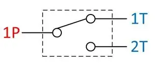

A SPDT (Single Pole Double Throw) button would be your ultra efficient button.
Source: http://www.ni.com/white-paper/3960/en/
In your case the 1P would go to the MCU, the 1T to VCC, the 2T to GND.
Harry Svensson
  • 8,139
  • 53
  • +1.. it has always bugged me that subminiature SPDTs are either very hard to find or cost way too much... – Trevor_G Dec 12 '17 at 16:03
    @Trevor Yeah... some things are sadly very overpriced. While other items are underpriced (MCU for an example). You can't have it all. – Harry Svensson Dec 12 '17 at 18:16
  • This is a great idea. Sadly I didn't manage to find a SPDT CMS button that fit my needs. I'll keep this circuit in mind though – vionyst Dec 21 '17 at 07:57

How long will the button be pressed? If it is not a toggle switch (which keeps its state) but a momentary switch then the current flowing when the button is pressed is largely irrelevant due to the short time that the button is actually closed.
Either of the two circuit you show is OK, it does not matter.
You can assume that the input leakage and/or current into a MCU input is negligible. All MCUs are in CMOS technology these days and have a practically zero input current. So stop considering it, it is not there.
Instead of using an external resistor you could also use the internal pull-up resistor build into many MCU's inputs. This resistor might have a relatively low value (50 kohm perhaps) so a small current will flow when the button is pressed.
You can safely use even 1 Mohm resistor for a pull-up/pull-down. Only in very "dirty" (electrically speaking) environments you might need a lower value. You can also place a 100 nF capacitor in parallel with the switch to suppress interference from other circuits nearby.
Pro tip: Reserve a place for such a capacitor on the PCB, but do not mount a cap. yet. In case of issues: place it and see if that helps.
To detect the state of the switch, either use polling (as in TonyM's answer) or use an interrupt. It depends on the application which one is better for power consumption (of the MCU).
Bimpelrekkie
