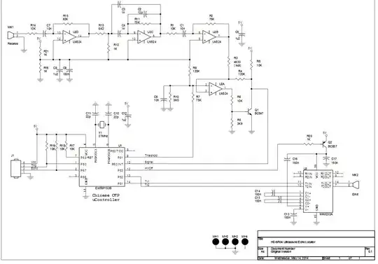

The processor on the HC-SR04 is EM78P153A. A man named Emil has done a lot of work recently (2014) on the HC-SR04. http://uglyduck.ath.cx/ep/archive/2014/01/Making_a_better_HC_SR04_Echo_Locator.html
Here is schematic he has derived on the HC-SR04 : (edit : I posted this because it gives an up close view of the analog section on the receiver portion) enter image description here

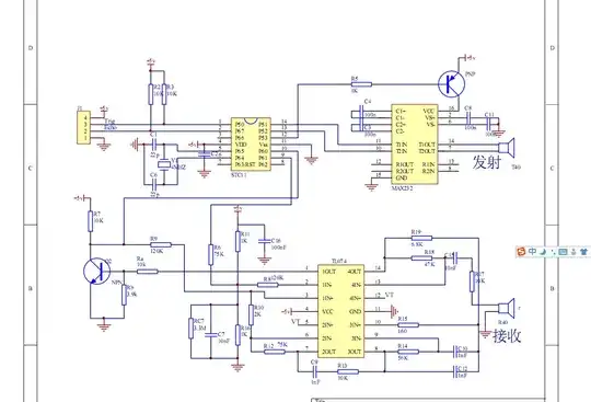

It seems like you are referring to something like this schematic:
Schematic
This is the datasheet for the stc11 series 8051 compatible microprocessors.

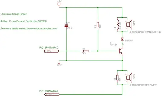

I don't think this is exactly what you are looking for as the controller (a PIC12C508) is a 16-pin SOIC. But it seems like a similar product. Maybe it will put you on the right track. Or maybe you could use one of these instead as you would have the full schematic. It is 3x as expensive as the HC-SR04 but I think a known PIC would be easier to modify than a brand-less micro.
http://www.robotstorehk.com/srf04tech.pdf
embedded.kyle
  • 8,411
  • 26
  • 44
  • Thanks for the reply - I'd seen the schematic of the SRF04 and another derivitive which is even closer to the HC-SR04 but, as you mention, they're PIC based which would be much easier to modify. I might just extract the controller and tack on a PIC with my own code in it. It just seems a pity to have to hack the board when everything is there that I need. It could make a VERY inexpensive bat detector! I can't really complain though - I only bought the module to extract the transducers!!! – Eddie Jun 24 '12 at 10:20
