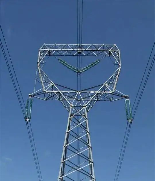

Overhead Cable (triaxial) unsheathed
  • each 3 wire bundle carries same voltage to reduce arc and wind effects.

O/H lines benefit from spacing 2,3 or 4 conductor far apart for added strength against wind and raised breakdown effects from reduced E field divergence radius. This lowers L and raises C slightly but is still very low C values/km compare the high C/km of coaxial U/G cable due to the small gap r of the centre conductor to coaxial sheath.

enter image description here O/H lines are often triaxial as above.
O/H cable is often rated SIL characteristic wave impedance of 400 ohms and U/G cables are 50 ohms =+/-25% depending on ampacity and BIL rating.
