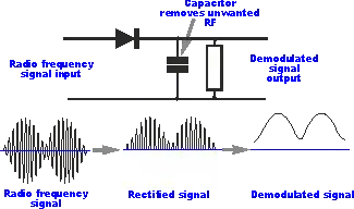

It's called an envelope detector. The diode prevents the base frequency from going negative. The original signal had an average value of 0. If you fed this through a low-pass filter (aka a capacitor), the output signal would be 0. With the diode in place, the signal can never go negative and now if you average out your signal using a low-pass filter, you get a slowly varying signal (relative to the base frequency) that no longer has an average of 0. This signal is now useful for the speaker.
enter image description here https://en.wikipedia.org/wiki/Envelope_detector

The diode demodulates the AM radio signal. To demodulate (recover the audio signal) from an AM radio signal all that is needed is to retrieve the amplitude of the signal:
Source: this article
That's what the diode does.
It blocks the negative part of the wave but lets the positive part pass. This together with the capacitor recovers the audio signal.
Your example does not contain a resistor and a capacitor, they are present though. The headphones can only work on audio signals so it basically performs the same function (a low pass filter) without needing those components.
