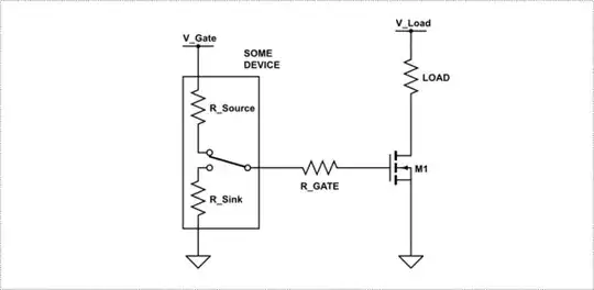

Let's look at your typical MOSFET circuit.
NOTE: I am only going to illustrate N-Channel devices here, but P-Channel works by the same mechanisms.
So we know the device is voltage driven so why do we need \$R_{GATE}\$. In order to understand why \$R_{GATE}\$ is important we need to augment this model to include the capacitances of the MOSFET.
simulate this circuit
\$R_g\$ is the resistance of the device legs and bonding wire to the gate itself. It is normally a very small value in the ones or twos. The two capacitors, one from gate to source \$C_{GS}\$, the other from gate to drain \$C_{GD}\$, however are significant.
To complicate matters further, those capacitances are not constant and change depending on the applied voltages. A typical example is shown below.
You can see that when the driving device switches the output from say low to high, the output is basically pinned to ground through \$C_{GS}\$ and through \$C_{GD}\$. As such the initial current taken from the driving device is bound by the following equation..
\$I_{gate} = V_{Gate}/(R_{source} + R_{GATE} + R_g)\$
Since the driving device will have a maximum drive current, you need to chose a minimum value of \$R_{GATE}\$ to ensure that value is never exceeded. However, singe \$R_g\$ is small and it is not always possible to determine the source and sink impedances of the driver, it is common to reduce the equation to simply..
\$R_{GATE} = V_{Gate}/(I_{max})\$
NOTE: It is possible to use two gate resistors, with associated diodes if the source and sink limits are different in the driver, or a need be to sharpen either the turn on or turn off edges.

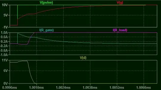

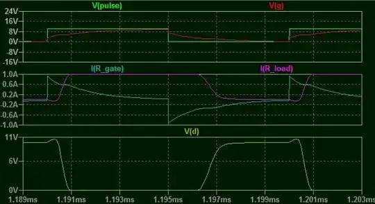

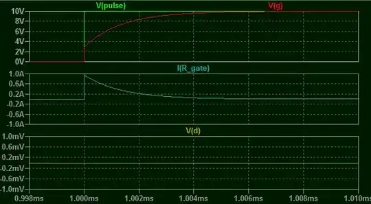

Here I have chosen a typical MOSFET which has around 2.5 ohms input resistance. With the drain shorted to ground as shown above the following traces can be plotted at the rising edge of the pules.
As you can see, as we predicted the current in \$R_{Gate}\$ initially starts out limited by the resistances at 1A and decays exponentially to zero. Meanwhile the voltage at the gate itself rises exponentially to the applied gate voltage of 10V. No surprises here, other than the sharp edge at the start of Vg which I believe to be a simulator artifact, likely as a result of the input inductance of the model.
The falling edge of the pulse is, not surprisingly, similar.
Ok so let's apply a small voltage, 1V, to the gate, with a 1 Ohm load resistor.
There are three things you should note in the above traces.
  1. Notice the bump in \$V_{D}\$. As the voltage rises at the gate, the top of \$C_{GD}\$ is pushed up above the rail voltage. Since the MOSFET is still off at this time, \$C_{GD}\$ must discharge through the load resistor as shown in the I(R_LOAD) trace.
  2. The MOSFET does not turn on for about 653nS after the pulse edge when the gate voltage has had time to charge sufficiently to the threshold voltage. Obviously making \$R_{GATE}\$ too large will delay this even further.
  3. If you have an eagle eye, you may also notice a slight deflection in I(R_GATE) as the MOSFET turn on.
Ok now let me show you a more realistic voltage with 10V and 10 Ohms on the load.
What should stand out to you in the above is the distinct flat spot in the gate current and \$V_{gs}\$. What is causing that?
When \$V_{GS}\$ reaches the turn-on threshold, the device begins to conduct and this causes \$C_{GD}\$ to begin to discharge though the device itself. This effectively "sucks" more current through the gate which significantly reduces the rate at which the gate voltage can rise. As it does slowly rise, the device turns on a little more, discharging \$C_{GD}\$ a little faster, and so on till eventually \$C_{GD}\$ is discharged down to the same level as \$C_{GS}\$. After that the combination charges as normal, and \$V_{GS}\$ exponentially rises to the target value again.
