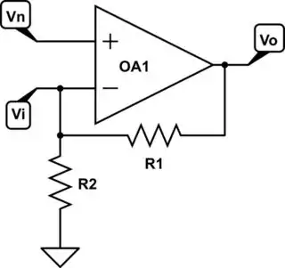

The result will be that there is some steady state error in the output. You can look at this as a closed loop P-only control system.
Say you have the following:
OA1 is a bad op amp with an open loop gain of 100 at DC. It will always take the differential input voltage and multiply it by the open loop gain to determine the output voltage. See also a related answer of mine.
This logic holds in any op amp circuit, even if we add feedback resistors. It will always obey the closed loop transfer function $$\frac{G(s)}{1+G(s)H(s)}$$
Where G(s) is the open loop transfer function of the op amp and H(s) is the transfer function of the feedback circuit you put around the op amp.

The op amp's open loop voltage gain is given by equation (1),
$$ A = \frac{V_o}{V_n-V_i} \;\;\;\;\;\;\;\;\;\;(1) $$
where
A  := The op amp's open-loop gain
Vo := The op amp's output voltage
Vn := The voltage at the op amp's non-inverting input
Vi := The voltage at the op amp's inverting input
Rearrange equation (1) to solve for \$V_i\$, the voltage at the op amp's non-inverting input, as shown in equation (2):
$$ V_i = V_n - \frac{V_o}{A} \;\;\;\;\;\;\;\;\;\;(2) $$
But suppose for a non-inverting amplifier that the open loop gain is something like 100. What would that mean for the resistances and input/output voltages?
Consider the non-inverting op amp circuit shown in Figure 1:
Figure 1. Op amp non-inverting voltage amplifier circuit.
The voltage \$V_i\$ at the op amp's inverting input can now be expressed two ways, as shown in equation (3):
$$ V_i = V_n - \frac{V_o}{A} = \frac{V_o\,R2}{R1+R2} \;\;\;\;\;\;\;\;\;\;(3) $$
Solving equation (3) for \$V_o\$ yields equation (4),
$$ V_o = \frac{A\,V_n(R1+R2)}{R1+R2+A\,R2} \;\;\;\;\;\;\;\;\;\;(4) $$
Equation (4) holds the mathematical answers to the questions you posed.
Note that taking the limit of equation (4) as the op amp's open loop voltage gain \$A\$ tends to zero, or toward +infinity yields the results shown in equations (5) and (6), respectively:
$$ \lim_{A\rightarrow 0} V_o(A) = 0 \;\;\;\;\;\;\;\;\;\;(5) \\[0.2in] \lim_{A\rightarrow +\infty} V_o(A) = \frac{V_n\,R2}{R1+R2} \;\;\;\;\;\;\;\;\;\;(6) $$
From equation (6) it is evident that we want the op amp's open loop voltage gain to be very high because we can then leverage the simplified voltage gain model shown on the right-hand side (RHS) of equation (6), instead of using the more complicated model shown on the RHS of equation (4).
One can perform parametric sensitivity analysis on equation (4) to determine the sensitivity of the op amp's output voltage \$V_o\$ with respect to (for example) the op amp's open loop voltage gain \$A\$, i.e., \$S_{V_o,A}\$. There are various methods for performing sensitivity analysis—e.g., absolute, relative, semi-relative, etc.—none of which can be explained here (by me) in "100 words or less".
