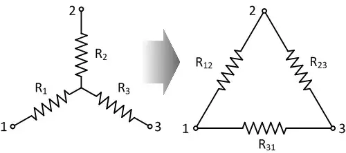

In the following question, I will use the notation of the following picture.
Source: https://www.quora.com/What-is-the-difference-between-star-delta-connection-in-3-phase-system

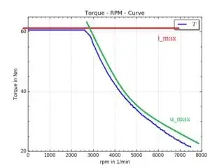

The reason, why this equation is important, is the computation of the maximum torque curve. The definition of that curve is the maximum torque the engine can produce for each rotational speed. There are two restrictions \$i_{max}\$ from the power supply and \$u_{max}\$ from the converter.
Computing the rms values of both current and voltage (Eq \eqref{1}), one can compute the curve by $$\begin{align*} \text{for each rot-speed } n \text{ find} &&\max T(i,γ) \\ \text{such that}&& i_{rms}^k<i_{max} \\ &&u^k_{rms} <u_{max} \end{align*}$$
with the electrical displacement angle γ in the region of field weakening. The result will be a graph like that
The software I am using to simulate electrical machines uses the Wye connection to compute all results. Having a motor with a delta connection I need to transform: $$\begin{align*} u_{ind}^{\star,1} &→ u_{ind}^{Δ,12} \\ i^{\star,1} &→ i^{Δ,12} \\ R^{\star} &→ R^Δ \end{align*} $$ so that it is possible to evaluate \eqref{1} in the delta scheme.
The resistance can be transformed quite simple using the rules written on wikipedia.

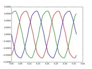

The current is an ideal sinusoidal value, so one can just apply the √3-factor to transform from wye to delta. If the induced voltage would be sinusoidal, you could transform it as well. But it is not, as you can see in the following picture of the three induced voltages.
This picture is just the computation of one specific configuration. So the "sinusoidalness" can be better, but also worse.
