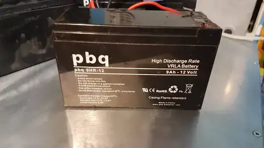

I found a 2U server UPS by APC, that uses 4 sealed Pb batteries (12V 9Ah, 2 in series, 2 times in paraler, so the pack is 24V). The batteries are totaly dead (after 8 hours of charging, they roughly give 3V and 2 of them have more rounded shape than a rectangular one. original batteries
I would like to use that UPS to power some of my devices, but buying new batteries from APC isn't cheap. However, It's almost quarter a price to buy 2 new car batteries. When connected in series, they also have 24V, but more Ah and propably could provide more amps than the sealed ones, so powering the UPS is no problem and they even should last longer. I tried the UPS on set of old ones and it works fine.
But I'm worried about charging them. If the power goes out, the UPS will run for some time and drain them. BUT will the UPS be able to charge them again (I expect it would take much longer if so), and if it will, is there any chance that the UPS will damage them during charging? If so, is there any way to prevent it?
I'm on a low budget and I would like the build to be as cheap as possible. I got the UPS from electronics dumpster (the sealed batteries inflated so much they couldn't be removed from the UPS without using very hard force, that's propably why some throwed away fully-working (but about 5 y.o.) 1300$ UPS), and pack of these 4 sealed batteries is 370$ in my country, while 12V 45Ah car battery is like 50$ each.

  • The battery shown does not give any indication of being deep-discharge. Fot float use and occasional discharge as in a UPS it's OK. A car battery will perform a similar function. The UPS should charge a car battery OK - ideally capacity should be similar. || Note that a rounded dead battery on long charge MAY suddenly explode, rupturing the case and throwing contents over a wide area. || For longer life try to limit discharge of car batteries to a lowish discharge %age. 20% discharge (DOD) to 80% capacity is good. More reduces lifetime but gives more capacity.. – Russell McMahon Nov 30 '17 at 19:01
After combining them 2p2s, you have a 24V, 18Ah battery pack. Your best bet is to replace with something very similar, say 15-25Ah @ 24V. I would use AGM batteries. I don't think it matters very much if the batteries are advertised as starting batteries or deep cycle. As long as they are AGM. AGM are a lot safer than flooded lead acid for areas where people are working all the time. Flooded batteries can out-gas hydrogen, and they can break or tip and spill. In theory, the hydrogen can accumulate and eventually ignite causing a fire or explosion.
