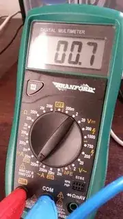

EDIT: After seeing the comments and the answer, I tried to measure the current in full sun. I get this:
Photo of digital ammeter reading 0.7mA

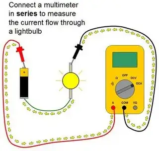

This mean that the current is 0.7 mA, right? It's the first time I'm doing this and I followed this sketch to measure the current with a multimeter:
hand drawing of circuit to measure current
In my case, the battery is the solar panel and the light bulb is the phone.

  • Apparently I get 0.7 mA (if the measurements from above is correct). How is this possible? – Physther Nov 29 '17 at 12:09
    You have the meter on the 200mA range but the red lead is in the 20A socket. Leave the lead where it is. On your meter it look like you should change the range to 20mA (20A in yellow). Try again. – Steve G Nov 29 '17 at 12:20

    You're in the wrong socket. The meter's rotary switch has a legend around the outside indicating which range you are in. Near those markings is a "20A" icon *only for those positions where you should be in the 20A socket*. You are not in one of them. – Harper - Reinstate Monica Nov 29 '17 at 15:29

21
You're hooked up wrong.
The meter's big rotary switch has a legend around the outside indicating range. Obviously, there are as many range markings as there are switch positions. Only two of them have the "20A" icon, which indicates you should use the 20A socket instead of the V/ma/ohm socket.
You have not selected one of those positions, yet you are using the 20A socket, That's not going to work. You're sending the power through the ammeter shunt, but the meter doesn't know to rescale.
Try turning the meter knob one notch clockwise.
If that yields a measurement that is too small or out of range, then select an appropriate range and use the other socket.

  • The two "20A" Icons indicate the AC-Current and DC-Current Groups (max. 20A). It looks fine for me. – Robin Dec 06 '17 at 07:55
