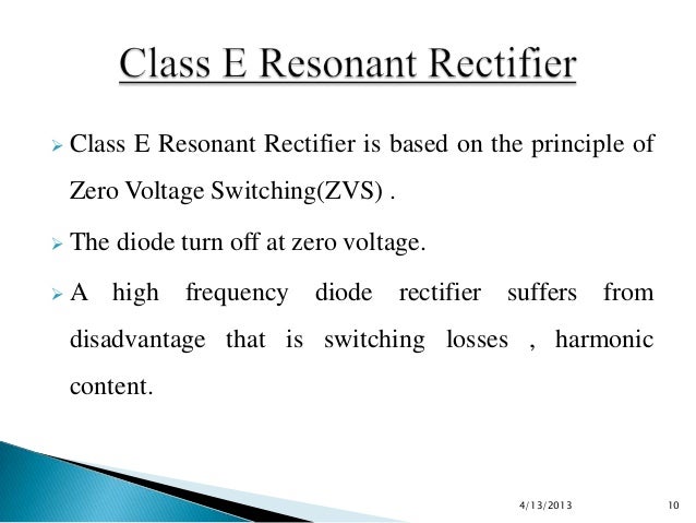

For example this paper Low Power Very High Frequency Switch-Mode Power Supply With 50 V Input and 5 V Output has the following sentence: "Just as the MOSFET has an output capacitance, the diode has a junction capacitance. In order not to dissipate this energy in the diode, it is important that the transition is made smoothly, so the capacitance is discharged before the diode turns on." What is the other option? Turn the diode on before it's junction capacitance has been discharged? How could you possibly do that? This point has been made in lots of other sources too i.e. this slide lists "The diode turn off at zero voltage" as a property of resonant rectifier. Because of this I am a bit unsure if I understand the whole concept at all or not.
