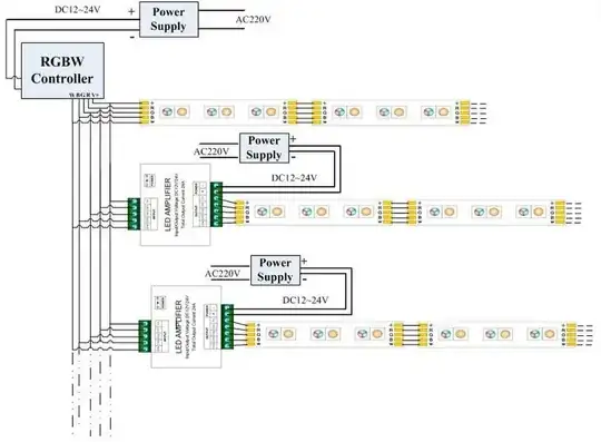

Your options are to dead-bug the mosfets, use terminal strips, use a heavy copper clad board. Or use led strip amplifiers, which are basically pre-built led drivers in a box:
Which comes to the second issue. You will most likely not want to wire all 7 Strips in series. You would need beefier mosfets, you will run into voltage drop along the FPC that the led strips are made of which means color drop and heat issues. You want to wire a few in parallel, or run wires from your supply to different sections of the strip. Like the picture above.
