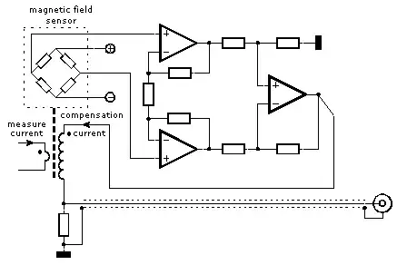

This is one way of doing it. Ref
A normal transformer can't deal with DC currents. Therefore the operating principle of DC current probes is rather different from AC probes. Here also is the current carrying conductor the primary winding and is inserted through the core opening. There is also a secondary winding, but now it functions as a compensation coil. The core is provided with an air gap that holds a sensor, e.g. a hall-sensor, which measures the magnetic flux in the core.
The current in the primary wire will magnetize the core. This magnetic field is measured with the sensor and as a result of this, the control circuit runs a current through the compensation winding in a way that the magnetic flux in the core is kept zero. As a result of this the core will never be magnetized. The advantage is that the non-linear properties and hysteresis of both the core and the magnetic sensor have little influence on the measurement results.
Beside the described measurement circuit there is also demagnetization circuit. Before using the current probe the core must be degaussed without wires inserted in the core.
Gain can be increased with compensation turns ratio at the expense of bandwidth.

    Hall sensors are best used in a bridge like my answer because they are very non-linear. In differential mode they are very accurate. – Tony Stewart EE75 Nov 22 '17 at 20:12
