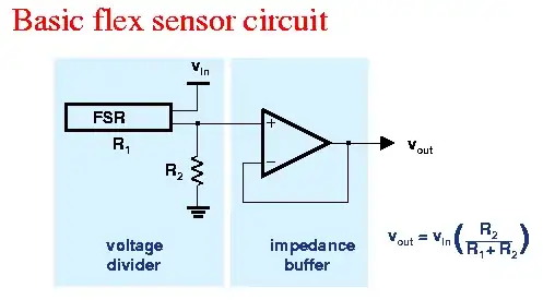

They're pretty easy to use as they act just like a variable resistor, whose resistance changes as you bend it. You can make them into an analogue sensor by adding a fixed resistor. The impedance buffer (an op-amp) is optional, but will result in much better sensor readings, especially as you intend to use fairly long wires to connect the sensor to the Arduino.
Flex sensor circuit
The datasheet for the sensor (which you should read) contains lots more suggestions for circuits.

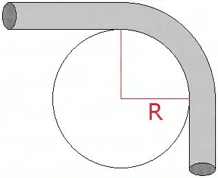

Robustness: What will kill the sensor is not the angle of the bend, but the minimum bend radius.
Minimum bend radius
The datasheet for the ones at Sparkfun didn't mention a minimum bend radius, but these ones specify 5mm. I.E. you can bend one around a 10mm diameter tube, and they'll be fine. So I would imagine that going round the outside of an elbow would be OK, but the inside would probably pinch the sensor and break it.
