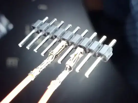

Notice the two pins on both sides are longer, and the two in the center are shorter. This ensures connections are made in the proper order (and also broken in the proper order when unplugging).
If the connector is not designed for hot plugging, there is no such guarantee.
The order you want is:
  • First, Ground/shield.
This ensures both sides agree on what "0V" is, and also discharges any static electricity safely. Sometimes a tiny spark is visible. You do not want to connect the ESD sensitive pins first!
  • Second, power supply.
  • Third, signals
Order is very important. You really want to avoid applying voltage to the signal pins of an unpowered chip, as current will then flow through the ESD protection diodes, and the chip will be powered from its IO pins. This can damage the chip.
Also, if ground connects last, then the signal lines will act as ground instead, and current will flow in them. If the device contains 3V3 chips powered by a LDO from the +5V from USB and ground isn't connected, who knows what the voltages inside the device are going to be...

  • For hobby/development stuff where you can use header-style connectors with all the pins in it (so not separate jumper wires), you could snip a bit off some pins to mimic what USB does. Taking care that it probably affects the max current rating. And try to insert them from a straight angle :p – Bart van Heukelom Feb 03 '22 at 09:20

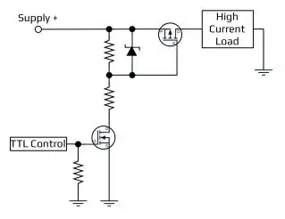

I have also had great success in implementing both strategies below. One thing you can do in design if your rolling your own hot swap system is find a standard connector (I used sca2 for my bus, but you could use sata, or another industry standard connector, just make sure people understand they can't plug other stuff into it).
Precharge Circuitry:
A long pin and current limiting resistor may be used to limit inrush current to a device. The long pin mates first; the current limit must be set so that the host system power rails stay within specification, but the device charges up adequately before the power and signal pins make connection. Care must be taken when choosing a pre-charge resistor value, the following scenarios show some common problems: If the pre-charge resistor value is too small, the device will still draw too much current on insertion, causing the system power rails to drop out of regulation.
Hot swap controller
A hot swap controller IC controls inrush current to a device. Hot swap controllers typically incorporate electronic fusing, and in high current applications it may be difficult to distinguish between inrush current and a short circuit. The components are more expensive than pre-charge resistors and in some cases the use of more active components in the system may introduce reliability concerns.
Image and text source: Design Considerations for Hot Swap
