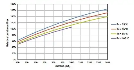

LEDs are rated by their emitted flux in Candela, Lumens, Photons (µmol), and/or Radiant power (mW) at a specific current and temperature.
For example there are many 1 Watt LEDs. At the same electrical wattage (Vf x current) another LED will have a different emitted flux.
LEDs produce both radiated flux (light) and non-radiated flux (heat). The sum of these two flux types will equal the electrical wattage.
The ratio of the radiated flux to electrical wattage is the LED's efficacy.
The forward current is only one factor in the wattage. Forward voltage is the other. You need to look at both factors.
All LEDs have a range (min typ max) of emitted flux at a specific current.
When comparing LEDs you cannot just look at the Relative Flux vs. Current but also factor in the forward voltage at the target current and temperature.
Also you must be aware the relative flux curves can be Luminous (Photometric) or Radiant (Radiometric).
Forward Voltage and Temperature
Forward Current and Temperature
Luminous and Radiant
