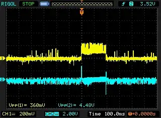

See attached for screenshot of the oscilloscope, with the probe being on the MCP4921 output (after the AC coupling cap). Also attached is the schematic. The schematic does not show the two possible solutions which I mentioned above. The purpose of the V_REF Resistors is to make a voltage divider that will give 0.25V at the V_Ref of the MCP4921. This was done so that the default gain of the amplifier, 20, will produce a 5Vp-p signal at the speaker.
Oscilloscope Output, Yellow is output of the MCP4921, past the AC Coupling cap, and Blue is at the speaker

You need to change your software so that between outputs of the audio you set the DAC to the mean voltage of the audio - presumably half-scale (0x80).
Then the audio will not be on a pedestal.
Most of these types of DACs use unsigned binary coding. To use it for audio you need to offer the audio by half-full scale so that you can go either positive or negative relative to the zero level.
Between audio clips you need to set your DAC to hat same level.
It doesn't look like you need any hardware changes.

  • I tried your solution, by just doing an if...else statement, where if a certain amount of time elapsed, a sound would play, else I am just constantly inputting 0x80 to the DAC like you suggested. Although the zero of the "off" waveform is now in line with the "on" waveform, I still get the clicks in the beginning and end when the sound plays. – user2608147 Nov 13 '17 at 21:38
  • You also need to ensure that the clips start and end with 0x80 to avoid a transient. You may also need to fade-in and out. – Kevin White Nov 14 '17 at 00:29
In addition to Kevin's fix, I would suggest you generate a full scale triangle waveform to verify your DAC output is monotonic and symmetrical to Vdd then the LM386 pin 3(+in) needs to be biased to Vdd/2 so you can bypass the 10uF ac coupling for DC coupling. Then the (-) should have the same value R to reduce (Iin bias * R)*Av = Vout offset error.
  • When you say monotonic and symmetrical to Vdd, do you mean that the triangle wave should start at 0 V and peak at Vdd, and then go back down to 0 V? Assuming this is what you meant, I don't reach Vdd in my circuit because my Vref is 0.25 V on the DAC, so the waveform goes between 0 and 0.25 V? – user2608147 Nov 13 '17 at 21:30
  • Whatever, try a full scale triangle and verify signal integrity. Right now it has many issues – Tony Stewart EE75 Nov 14 '17 at 04:08
