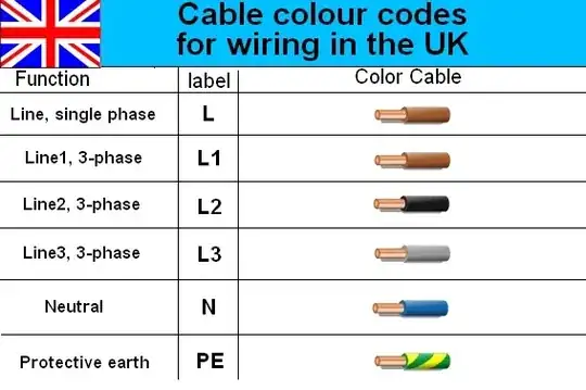

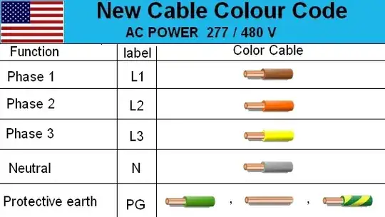

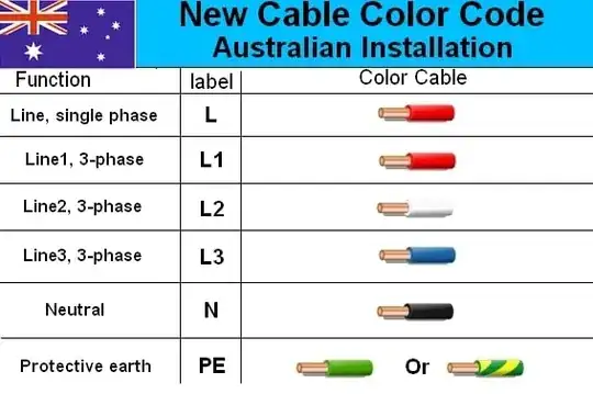

It seems these are the new colour standards for equipment, based on the most recent National Electrical Standards as of 2010 thru 2017. I have confirmed they are accurate.
New cable colour code for Three Phase
  • Phase 1 - Brown
  • Phase 2 - Black
  • Phase 3 - Grey
  • Neutral - Light Blue
  • Earth - Green/Yellow
FWIW
enter image description here enter image description here enter image description here enter image description here enter image description here enter image description here
    Can I ask for the source of these tables please – Seano Nov 07 '17 at 04:23
  • The tables, or equivalent, are in the wikipedia article I linked to in my answer. – user57037 Nov 07 '17 at 04:30
  • The blue colours in those images (the originals in the Wikipedia article, and the images above) are rather poor, particularly the dark blue. (I have great difficulty distinguishing between them when they're not adjacent to each other.) For the "Australian Equipment" table above it looks like the dark blue image has been used, rather than the light blue one. – ovirt Dec 12 '17 at 07:25
  • I agree, the professional photographer who took them was more interested in the beauty of gradient dark shadows than the accuracy of a single color so disregard anything in the shadows. Is it my imagination that AU think Red-Wh & Blue are all hot (heads) and Black is Neutral while USA thinks Whites are Neutral? while EU uses Smirf color for neutral. I think there is some social statement in this. – Tony Stewart EE75 Dec 12 '17 at 19:25
  • @TonyStewartSunnyskyguyEE75 Which Photographer? – Rainb Feb 14 '21 at 12:27
