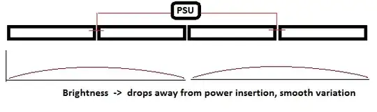

Feed from the 1/4 and 3/4 points...
A 20m strip is probably four 5m strips. Place your power supplies between strips 1 and 2 ... and between strips 3 and 4. That way each leg of your power is supplying only one 5m strip. The strips are built for this.

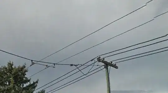

If you ever look at trolley-bus wires, they have 2 bare conductors over the street about 2' apart. Then every few poles, they have a jumper over to two much heavier power wires running along the poles -- those are feeders. Here's a photo from Dayton. Note the hanger and cross-wire are "hot" and feed the left (+) wire, insulating the right (-) wire, then jumpered to a feeder (note the double feeders). These jumpers exist every 4-6 poles.
You do the same thing. You choose a feeder cable of sufficient size to avoid voltage drop, and then tie it together everywhere you can. This results in the PCB traces and the feeder being fully paralleled, but there is nothing wrong with paralleling feeder when it is DC. That's what feeder is.
