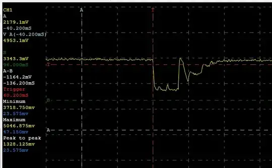

Following the suggestions here I fed the comparator with signals ranging from 500hz to 20000hz and offset by 2.5VDC. I mostly observed the same result: with RV1 at one extreme, a 5V flatline, at the other, 0V, and in between a waveform of about .5Vp/p and offset at around 2.5V (the offset varied depending on RV1).
500hz
The closest I ever got to expected output had flat peaks at 5V but still not swinging between 0 and 5V.
100hz
This would seem to rule out scope issues, so it must be either the electrical environment (I'm using a breadboard) or else I've wired it wrong (which I doubt, but I will certainly be triple and quadruple checking). Or possibly a dud chip, which also seems unlikely.

I believe my problems were caused by a noisy power supply (5V unfiltered USB), and exacerbated by stray capacitance from the breadboard. With the USB supply the comparator seemed to have 3 states: flatlining at 0V, flatlining at 5V, or the voltage at the input. This was the case even without any signal, just 2.5VDC. I'm guessing the "middle state" was high frequency oscillation. I managed to get the expected output by powering the circuit from a battery and got best results when I removed it completely from the breadboard. Only then did I get only 0V or 5V flat lines with no "middle state". On the breadboard and supplying a 1000hz signal, I see a 0-5V square wave with some zigs and zags around 2.5V, showing that the output is not a clean. I guess if I want to continue with this device I'll have to put it on its own board and filter the power supply. Thanks to everyone who contributed.
