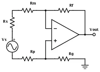

For example, how would you calculate the output noise of this circuit?
A differential op-amp circuit
Which noise sources do you include?

So first, you want to find the equivalent resistance seen from the inputs of the op-amp looking outward into the circuit, with voltage sources (such as the op-amp output) set to 0 V (equivalent to converting them to short-circuits to ground). For this circuit: $$ R_\mathrm{eq}=(R_\mathrm{m}+R_\mathrm{s}+R_\mathrm{p})\|(R_\mathrm{f}+R_\mathrm{g}) $$
Virtual ohmmeter looking out into the circuit from the op-amp inputs
So for example, if Rs = 100 Ω, Rm = Rp = 1 kΩ, and Rf = Rg = 100 kΩ, then Req = 2.1 kΩ.
To find the thermal noise of this equivalent resistance, use the Johnson–Nyquist formula: $$ v_\mathrm{n}={\sqrt {4k_{\text{B}}TR\Delta f}} $$ There are online calculators to do this for you:
For example, with Req = 2.1 kΩ, at 27 °C, with an audio bandwidth of 22 kHz, the resistors would contribute 0.87 μVRMS = −121 dBV input noise.

The current noise is probably irrelevant for an FET-input op-amp, so we can skip to calculating the output noise: Just multiply the input noise by the gain of the amplifier. However, you need to multiply by the "noise gain", not the signal gain. To find the noise gain of the amp, convert your existing sources into short circuits and put a test voltage source right in series with the non-inverting input of the amp:
Differential amplifier with noise source in series with non-inverting input for calculating noise gain
So the op-amp will do whatever it takes for the inverting input to equal the non-inverting input. There will be one current path: $$ I=\frac{V_\mathrm{out}}{R_\mathrm{f}+R_\mathrm{m}+R_\mathrm{s}+R_\mathrm{p}+R_\mathrm{g}} $$ and this is related to \$V_\mathrm{t}\$ by: $$ V_\mathrm{t}=I(R_\mathrm{m}+R_\mathrm{s}+R_\mathrm{p}) $$ combining and solving: $$ \frac {V_\mathrm{out}}{V_\mathrm{t}} = \frac {R_\mathrm{f}+R_\mathrm{m}+R_\mathrm{s}+R_\mathrm{p}+R_\mathrm{g}}{R_\mathrm{m}+R_\mathrm{s}+R_\mathrm{p}} $$ So in our case, this is a noise gain of 96.2× = +39.7 dB, and our input noise of −117 dBV becomes −77 dBV at the output. (A TINA simulation gives 137.5 μVRMS = −77 dBV, for comparison.)
