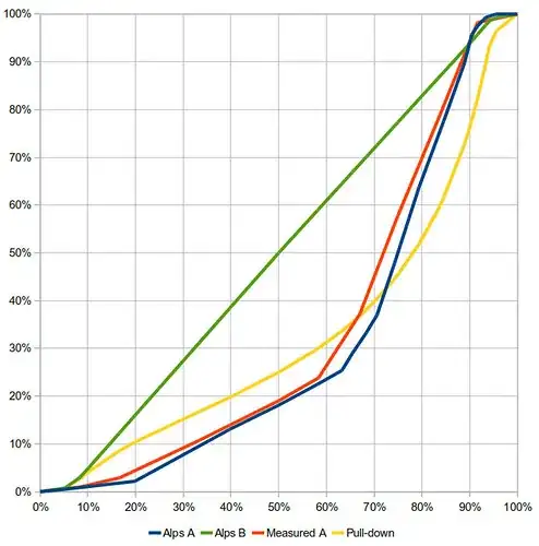

For illustration, here's a plot I made comparing linear pot, log taper pots, and linear pot with "pull-down resistor" to approximate a log taper. I'd like something that will plot the yellow curve, for different values of the pull-down resistor, so I can make it behave as closely as possible to the other curves, without having to enter an equation manually. Of course, my real applications are more complex, but this is an example of what I want to do.

  1. I measured the resistance of real-life pots of different tapers as a turned them to each of their detents and put all the measurements in a spreadsheet. It matches the manufacturer curves pretty well, with piecewise segments of different rates and showing end resistance, etc.
  2. I calculate the gain formula for a given circuit and then translate it to Excel (putting it in a different column which references the column for a specific taper) and make a graph so I can plot gain vs pot position while trying different circuits.
It's not as easy as drawing the circuit in a GUI, but it works, and the curves are as realistic as possible.
