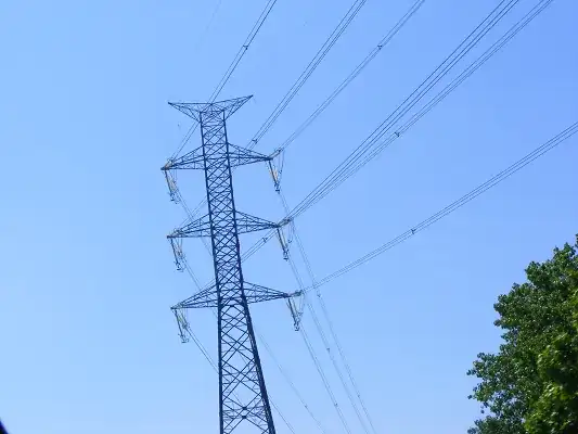

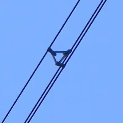

I shot these photos while travelling in a highway. In each line-group has three separate lines. I think that the three lines in each group carry the same electrical potential (if not, could they be so close to each other?).
Why are the three lines in each group isolated from each other?
Is there an electrical reason for this?

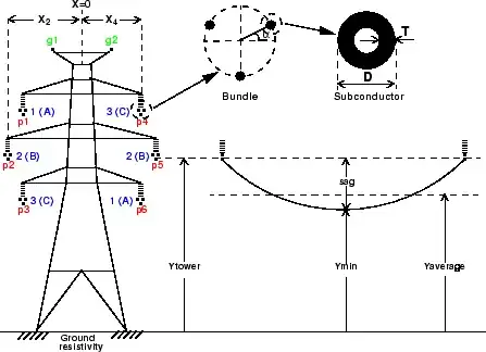

  • Impedance, power factor, corona discharge and resistive loss effects are improved by spacing a number of conductors apart to form a larger effective single conductor.
  • The combination of multiple wires in this manner is usually termed a "bundle".
Wikipedia notes
  • Bundle conductors are used to reduce corona losses and audible noise.
    Bundle conductors consist of several conductor cables connected by non-conducting spacers*.
    For 220 kV lines, two-conductor bundles are usually used,
    for 380 kV lines usually three or even four.
    American Electric Power[4] is building 765 kV lines using six conductors per phase in a bundle.
    Spacers must resist the forces due to wind, and magnetic forces during a short-circuit.
    Bundle conductors are used to increase the amount of current that may be carried in a line.
    Due to the skin effect, ampacity of conductors is not proportional to cross section, for the larger sizes.
    Therefore, bundle conductors may carry more current for a given weight.
    A bundle conductor results in lower reactance, compared to a single conductor. It reduces corona discharge loss at extra high voltage (EHV) and interference with communication systems.
    It also reduces voltage gradient in that range of voltage.
    As a disadvantage, the bundle conductors have higher wind loading.

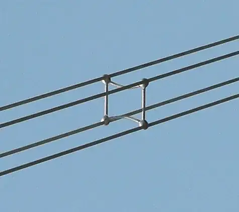

* Insulated / non-insulated spacers: Note that the above reference says "non conducting spacers". In fact, some are and some aren't. There is no obvious gain from insulating between wires although, a conducting spacer will probably carry some current with the potential for additional losses at the clamping joints. While the potential in all wires in a bundle is nominally identical, the magnitude of the fields produced and the imbalances due to line-line, line-ground and line-tower mean there will be some differences in voltage - probably small but more than may be intuitively obvious. Many spacers use elastomer bushes at the wire support points - aimed primarily at providing damping of Aeolian oscillations in the wires. As differences in voltage are low then these bushes may provide functional insulation.

    @Russell: You say a conducting spacer could carry some current, and therefore additional losses at the clamping points. These would be more than offset by the losses not incurred in the cable the current is not then using. Adding conductors can only make the total resistance lower, which lowers overall losses. Your statement brings up another possible reason though, which is that the spacers and their clamps are not equipped to deal with the current that could happen if things got out of ballance a bit, causing *local* heating and maybe corrosion. Admittedly guessing. – Olin Lathrop Jun 13 '12 at 15:32
    I've been assured by a friend who works on HV networks that these spacers are normally called spacer dampers and their primary purpose is mechanical rather than electrical. They aren't divided up into insulating and non-insulating though - he has never seen one that is genuinelly electrically insulated, just those that have neoprene bushings. – Cybergibbons Jun 14 '12 at 05:25
  • @Cybergibbons: Even if one endeavored to use insulating spacers, the maximum potential that could exist between wires in a bundle without something arcing over would be pretty limited. I would expect that a spacer design would not concern itself with preventing dielectric breakdown, but rather with assuring that intra-conductor currents that do flow can do so without causing damage. If there were two conductors A and B in a bundle, and a spacer divided them into segments A1, B1, A2, B2, and if material variations cause the resistance of A1 to exceed B1, and B2 to exceed A2... – supercat Feb 11 '13 at 16:02
  • ...that would imply that if the spacer had zero resistance, current would flow through it, and if it had non-zero resistance a potential would exist across it. How perfectly uniform are the conductors in a bundle apt to be? – supercat Feb 11 '13 at 16:09
Actually, they are connected to each other. The purpose of the thing in photo 4 is to maintain the desired mechanical spacing between the lines, not to insulate.
The reason for 3 lines together is for higher current capacity and to decrease corona losses.
You could make the cable thicker to get higher current capacity, but due to the skin effect you get returns relative to the square root of the amount of metal used, not linear with the amount of metal. Thick cables are also difficult to handle. Three smaller cables have less skin effect relative to the amount of metal used.
The other reason is to avoid high electric field strength in the air. Think of a single thin cable at high voltage. The electric field strength immediately around the cable would be very high. This goes down with the diameter of the cable. The three cables held at the right mechanical separation (hence the spacer in photo 4) look like one very thick cable to the outside for electric field purpose. The reason to keep the electric field down is that the air will break down at some field strength. This causes it to conduct a little and ionize, which takes energy, which is a loss from the point of view of trying to transmit energy from one place to another. Sometimes you can hear power lines crackle, especially at high humidity. That is due to a little bit of this happening. Some losses are acceptable since they cost less overall than a more expensive structure to avoid them. Electric companies juggle these tradeoffs very carefully since there is a lot of money at stake.

    The individual conductors in a bundle are isolated across a span - the spacers are insulators. This provides impedance effects that would not exist if a conductive spacer was used. – Russell McMahon Jun 12 '12 at 14:58
  • @Russell: Are you really sure about that? In your first picture in particular the spacer seems to be made of metal. In the second the disc could be some ceramic is suppose. Have you ever seen one of these spacers up close? Also, what impedance effects? If all is ballanced correctly, there should be no current thru the spacers anyway. – Olin Lathrop Jun 13 '12 at 12:57
  • Olin - Insulation seems to often happen and may have some positive effects but it's not a major factor. See added "Insulated / non-insulated spacers:"in my answer. – Russell McMahon Jun 13 '12 at 15:09
