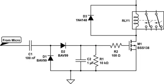

Editing to add a charge pump example...
In reality I would probably use a dual diode in a SOT23 or such and the cap values will need tuning to taste, but it gives the basic idea.
The resistor discharges C2 making the relay turn off shortly after the pulsing goes away on the micro pin.
