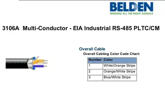

I have a serial comms project coming up. A number of boards with RS-485 interfaces need to communicate. Date rate is 57600bps and cable length will be less than a few hundred feet.
Will shielded CAT5 cable work well enough in this situation or should I pay the extra for "true" RS-485 cable such as this one?
I cannot easily visit the install site ahead of time as it's interstate. I do have the same boards here in the lab I can test with however.

While often shielded, CAT5 can be of the UTP type, meaning unshielded twisted pair. The "true" RS-485 cable you link to has two twisted pairs and a shield. If I remember right, CAT5e (and above) has a shield, at least most cables I have seen have - the exact standard can vary. I guess those would do the job just nice. Just make sure you use the twisted pair like in the original RS-485 cable (your data sheet looks like [1 White/Orange Stripe] and [2 Orange/White Stripe] are a twisted pair, and [3 Blue/White Stripe] is a third, untwisted wire.)
