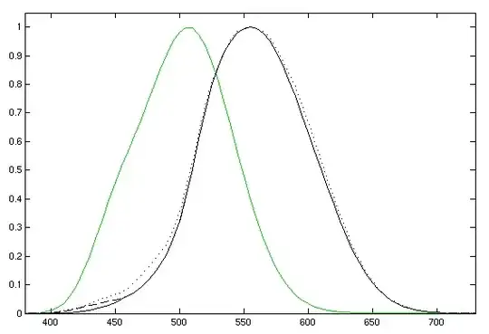

Wikipedia shows the spectral sensitivity for the human eye here:
Note that two different curves are shown: the green curve represents scotopic vision, which is when the eye is adapted for dark conditions, and the black curve represents photopic vision, when the eye is adapted to bright conditions, and more sensitive to color.
Because the candela is a photometric unit, it takes this spectral sensitivity into account--photometric units are based on the luminous flux of a light source, which is determined by multiplying the power spectrum of a source by a luminosity function representing the human eye's spectral sensitivity and then integrating, as opposed to radiometric units, which are based on the total radiant power of a light source, which is simply the integral of the power spectrum.
So comparing candela ratings should be apples to apples, but if you take another look at the graph, note that there is more than one black curve. These represent different curves established at different times. Because there are different curves, photometric measurements are only directly comparable if they were obtained using the same luminosity function, and unfortunately the specific function used is not often specified for indicator LEDs (it is more likely to be specified for high power LEDs intended for illumination). But for most purposes the numbers will be close enough for a rough idea.
