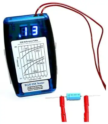

Helpful Device #1: Blue ESR Tester
I got this device, the Blue ESR Tester Kit - Requires Assembly, because it can measure the ESR of a capacitor in-circuit, and because it's relatively reasonably priced at a current price of around $96 USD. But it's also available pre-assembled Blue ESR Tester Kit - Fully Assembly, for about $117 USD. Prices as of 1-26-2022. And it also measures shunts and resistors down to 0.01 ohm. I have no affiliation or profit from this product, and I don't know anybody at Anatek (the manufacturer). If it sounds like I'm promoting it, it's because I wish I found it sooner.
Blue ESR Tester

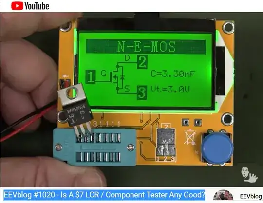

M328 (LCR-T4) Model Transistor Tester (not a kit)
Dave of EEVBlog fame reviewed an earlier version of this device, a M328 (LCR-T4) model component tester here at EEVblog #1020 - Is A $7 LCR / Component Tester Any Good?, although I don't know if Dave ran the calibration step first, so some of the inaccuracies he reports may be overstated. Here is the EEVBlog page itself, which has more related links. This device costs less, than the GM328, even as low as $7, according to Dave.
Yellow M328 (LCR-T4) model component tester
