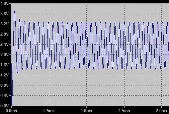

Just to add yet another post on this. Here's a circuit that should actually work, using a quad LT1631 and a single power supply rail:
The output frequency should be close to about \$\frac{1}{2\pi R C}\$ or near \$15.9\:\textrm{kHz}\$ for the given values of \$R=1\:\textrm{k}\Omega\$ and \$C=10\:\textrm{nF}\$ shown in the above schematic.
Here's the output from LTSpice:
You should be able to replicate similar results in your own simulator.
(For a cheaper arrangement, try the TI LMV324IPWR quad package device, instead.)
