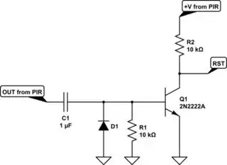

Here's the schematic I had mentioned in the comments:
The main idea is that pulling up rapidly on \$C_1\$ also pulls up on the other side of \$C_1\$ (if \$C_1\$ has \$0\:\textrm{V}\$ across it, then hauling up on the left side means that the right side of \$C_1\$ will also be at the same voltage... for a moment.) This means the base of \$Q_1\$ is similarly pulled up and base current immediately activates \$Q_1\$ (while at the same time charging \$C_1\$ so that the right side of it moves towards ground.) \$R_1\$ also helps charge \$C_1\$ and together with the base current of \$Q_1\$ rapidly charges \$C_1\$ until there is no more base current for \$Q_1\$ to stay active. The exact duration here isn't terribly important, so long as it is "long enough" so that the collector of \$Q_1\$ is pulled down and causes the low-going RST pulse that's needed.
Once \$C_1\$ has developed a charge across it, and \$R_1\$ has helped to fully complete that job, \$Q_1\$ has to completely turn off and the RST line goes back high, again. It will stay there until there is another high-going edge at the left of \$C_1\$.
At some point later in time (\$\ge 2\:\textrm{s}\$), the left side of \$C_1\$ is hauled back down to ground. But \$C_1\$ is charged ([+] on the left, [-] on the right) and so hauling down on the left side causes the right side to have a rather negative voltage (below ground.) Here is where \$D_1\$ comes to the rescue, giving \$C_1\$ a way to (mostly) discharge; and quite rapidly. The rest of the charge can be removed by \$R_1\$ in order to completely reset and remove the voltage across \$C_1\$, readying it for another event.
The pulse width should be on the order of hundreds of microseconds -- long enough to get the job done, I think.
It might be wise to add a series resistor to \$C_1\$, as in:
simulate this circuit
Roughly \$1\:\textrm{k}\Omega\$ should be fine. A little less, if you like. This will limit the base current into \$Q_1\$ and decrease the charging rate, widening the pulse and helping make the behavior better managed than before.
There are other ways that are technically superior. Assuming that the output from the PIR may need to be "shaped," it's output might be fed to a Schmitt trigger circuit with that being followed by a one-shot timer (such as a 74LS121, for example.) Or, with a clean enough output from the PIR (probable here), just the 74LS121 would be enough. These can be set up to trigger on the rising or falling edge of their input (A vs B) and the timing of their output can be adjusted using an RC timing pair. You can choose the sense of the output, as well. So they are quite good for something like this.
But the above circuit might work okay for you. It's cheap and I suspect you already have the parts on hand. So that's nice, if it does work out.
jonk
  • 77,059
  • 73
  • 185
  • Thanks @jonk, I think I learned more about capacitors today than I did in that 1 semester electronics course I took at uni long ago :) – codemonkey Oct 02 '17 at 10:27
  • Some more info on p57 of "Analog and Digital Circuits for Electronic Control System Applications", by Gerald Luecke. Link: https://books.google.co.nz/books?id=lKy56FZkNzsC&pg=PA57&lpg=PA57&dq=electronics+differentiating+leading+edge+pulse&source=bl&ots=VCCHU9nF4v&sig=_Gk2vZrPCpK_WX3cdmtBX46FwbU&hl=en&sa=X&ved=0ahUKEwjHns365t_WAhVKSZoKHS3NC6YQ6AEILTAB#v=onepage&q=electronics%20differentiating%20leading%20edge%20pulse&f=false – codemonkey Oct 08 '17 at 01:04
  • @codemonkey Yeah. The middle (#3 of 5) chart in Figure 40 is what I had in mind, at the base. The BE junction only operates on the positive spike. The negative spike is why D1 and R1 are desired. – jonk Oct 08 '17 at 01:08

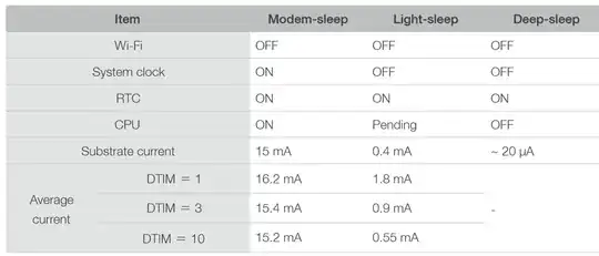

You could of course wake up from Deep-sleep based on the RTC clock instead of reset. Set the clock to say 100 ms and test the movement detector output when you wake. This would give reasonably low power operation and you don't need any extra components at all.
You could also use Light-sleep and a GPIO pin change to wake the MCU, but this will have a higher base level of sleep current at about 900 uA.
See the sleep documentation and here for calculations.
Jack Creasey
  • 21,428
  • Thanks, I considered this. This would have been plan B in case I can't fix it via interrupt to wake-up. The ESP spikes when booting, so consumption is high... I've also not been able to realize the suggested ~20uA deep sleep... Best I can get is 1.7mA. I'm begging to suspect it's something wrong with my cheap LoLin ESP board not supporting full deep sleep... – codemonkey Oct 02 '17 at 02:14
