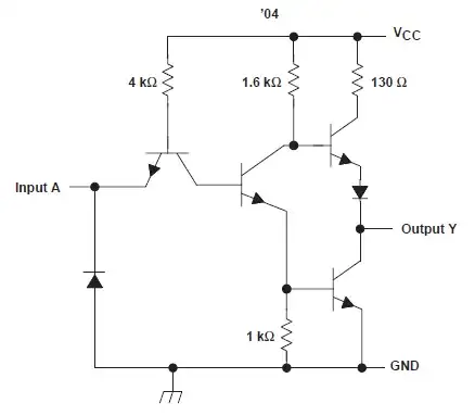

To start with, the floating input. In TTL floating inputs are the same as high, and they're not bad, as they are in CMOS. If you leave the input floating or make it high the second transistor will get current through the input transistor's base-collector junction, so the second transistor will conduct, and create a voltage drop over the 1k\$\Omega\$ resistor, which in turn will cause the lower output transistor to pull the output low. So it's indeed working as an inverter.
The output configuration is known as a totem-pole. It's kind of a push-pull, but with a difference: instead of a complementary NPN-PNP pair it uses two NPN transistors, and the diode an 130\$\Omega\$ resistor make it even more asymmetrical.
As a consequence a TTL totem-pole will be able to sink much more current than it can source, typically 16mA vs 0.4mA. So if you want to use TTL to control LEDs you'll want to connect the LED's anode via a resistor to \$V_{CC}\$ and sink the current.

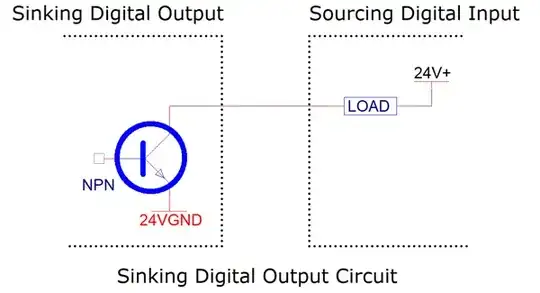

Here are two images of current sink and current source (e.g in a PLC device):
Note that current sink is often used with micro controllers that may have problem sourcing current.
Figure 1 shows a sinking digital output that is connected to a sourcing digital input.
In this circuit, the load is pulled to ground because of the sinking digital input provided.
Sinking digital output diagram
Image source: Proces-Data - Current Source and Current Sink

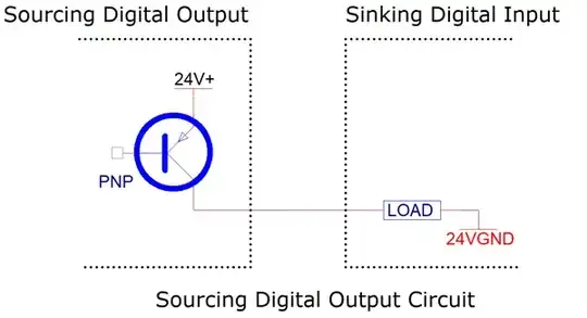

Figure 2 shows a sourcing digital output that is connected to a sinking digital input.
In this circuit, the load is pulled up to receive voltage because the sourcing digital input has been provided.
Sourcing digital output diagram

  • @vahid_rowghanian - I *think* you have made some mistakes in your text e.g. for the image showing a sinking digital *output*, you refer to a "sinking digital *input*". Similarly, for the image showing a sourcing digital *output*, you refer to a "sourcing digital *input*". Please review your text in comparison to the diagrams, and ensure the text is correct for each diagram. Thanks. – SamGibson Mar 26 '20 at 17:55
