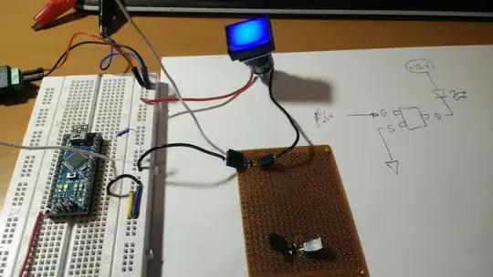

See my setup in the picture attached. After a fresh start with a new mosfet, new wiring and clean table it works! I believe the problem was:
  • The mosfet Drain and Source were connected as P-Ch so I had it the wrong way, and eventhough I reversed it, I damaged it. All tests after this were useless.
  • At some point I connected the mosfet the right way, however as the part was damaged I did not see any difference which confused me even more.
I need to check now with another smd n-ch mosfet that has a Vds of more that 24V.
btw, the code was ok (just blink LED sketch). ;)
Some pictures for anyone who might need help in a similar situation. The power supply on the top left dc jack is supplying 12V. The consumption is around 20mA which are mainly due to the Arduino Nano running the blink example sketch.
Serge
