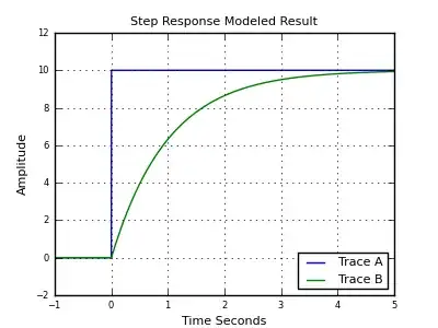

For a one dimensional signal it's very basic - it's an RC low-pass filter. Here is the transient response to a step change: -
Trace A is the step input and trace B is the output as indicated in the circuit below: -
