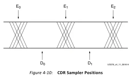

Here's what those sample points look like (UG578, page 193):
CDR Sampler Positions
