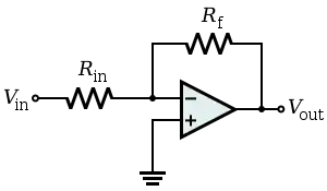

When we build op amp circuits that use negative feedback, like so:
inverting amplifier connection
... we can analyze the circuit very easily, by assuming that $$v^- = v^+$$ due to negative feedback (when also assuming the op amp is ideal, of course).
Besides the obvious high-precision cases where these simplified models break down, when is this and when is this not valid?
For example, if we replace the feedback resistor with some other element - perhaps a capacitor, inductor, diode (regular silicon diode, zener diode, etc.), or some combination of them and other common circuit elements - how do we know where this simplification is valid?
Also, even if we stay with a resistor as the feedback element, as the resistance becomes very, very high, at some point we can pretty much consider it an open circuit, and so clearly this model breaks down somewhere along the way.
So, the question is: under what constraints is this approximation "true enough" to give useful results?

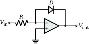

For another example, consider the basic inverting log amplifier circuit:
log amp circuit
If we solve the Shockley diode equation
$$i_D = I_S(e^{vD/VT} - 1)$$
for vD, we get $$v_D = VT \ln{\left(\frac{i_D}{I_S} \right)}$$ (ignoring the 1, which is mostly irrelevant as the exponential will be rather huge)
If we then use the virtual short method to see that $$i_D = \frac{v_{in} - 0}{R_{in}}$$ we get the correct expression for the output:
$$v_{out} = -VT \cdot \ln{\left( \frac{v_{in}}{I_S R_{in}} \right)}$$
So, the virtual short method works here. But since this diode will be an open circuit when $$v_{out} > v^-$$ I'm not sure how to figure out beforehand that the analysis will be valid.

As long as the Op-amp can set the inputs equal driving the output at a certain voltage, it will.
That assumption falls when it cannot, such as if it has an open circuit in the feedback (positive or negative). Then, it'll saturate to one of the rails, depending on which input is driven higher. Note that the open circuit feedback can be also a reversed diode.
Another case may be if the voltage that allows the equilibrium at the inputs is beyond the saturation voltages. Again, the op-amp will saturate and the input will unbalance.
But why the inputs have to be equal?
The op-amp has three operating regions, one called high-gain region, and two saturation regions. The rule that the inputs must be equal holds only for the high gain region, and comes from the fact that for the ideal op-amp:
$$V_{out} = \infty (V_d) = \infty (V_+ - V_-)$$
which means that the output voltage is finite only if the input voltages are equal, so the op-amp will force the output voltage to the value that zeroes the difference.
When the op-amp saturates, though, the output voltage is just given by
$$V_{out} = V_{sat}$$
which means that the op-amp is doing its best to set the inputs equal, but it's clashing against an amovable wall. So the inputs can unbalance to satisfy the output voltage.
In your example, you can find that the op-amp saturates when the input is equal or greater than:
$$ V_{in}^{SAT-} = - V_{SAT-}\frac{R_{in}}{R_{f}} $$
In your example circuit, when Vin is negative, V+ will be higher and then the output will saturate. There is no way then for the feedback to restore the equilibrium, because the diode will be reversed, so for every negative input the output will be the saturation voltage.
