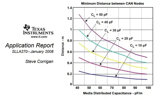

I ran into some troubles trying to design a wired bus which will connect in about 64 testing devices. My first choice of mind was CAN bus, known of it's reliability and low EMC interference. However, during my research, I have discovered that there is limitation of minimum distance between CAN nodes, related to load capacitance and media capacitance: http://www.ti.com/lit/an/slla270/slla270.pdf
The nodes are connected through PCB traces and connectors, I have estimated media capacitance of 0.62 pF/cm (single 1 mm width trace to ground plane through 2.1 mm FR-4, is it right way to calculate?) and TJA1040 transceiver has input capacitance of max 10 pF.

Node to node distance is about 60 mm. From the graph, minimum distance is about 180 mm.

  • Are you sure your Conductor Height (H) value is correct? 2.1mm seems high. Is your board two or four layers? A lower H value will increase the media distributed capacitance, which will improve your minimum distance. I've run several CAN nodes at much closer distances than what that graph suggests (granted, they weren't at the highest data rates either). – youtooth Sep 25 '17 at 18:59

  • Any reason that layer 2 isn't used as a ground plane here (even if locally for these signals)? Either way, whatever connectors and cables you're using will add additional capacitance onto the 62pF/m you've calculated. So it's likely that the your total distributed capacitance is closer to 100 pF/m (just a guess). These constraints also apply to all serial interfaces, so RS-485 will still have similar concerns. – youtooth Sep 25 '17 at 19:13

  • If you look at the app note you cited, you'll notice on page 12 that the given spacing parameters apply only in cases where you have a bus that is "electrically long". In your case, given that your entire bus is ~1m long, the potential for issues to arise isn't particularly high. – PKL Sep 25 '17 at 20:48
