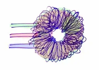

When looking at different transformer core designs, three phased, I never see any core designed as a circle or torus.
Why is that so? Will it not work as well as the common B-shaped core?

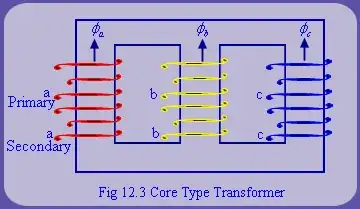

Figure 1. 3-phase transformer flux. Source: NPTEL.
In a three-phase transformer each primary and secondary pair are wound on the same "limb" or "branch". With the 120° phase difference on each branch the flux on one branch can always find a path on the other two so that there is always a flux circuit. For example, when the red phase (Fig. 1) is max upwards the yellow and blue will be 0.5 downwards.
This arrangement is not possible on a standard torroidal transformer.

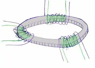

Figure 2. A three-phase "torroid" would have to look something like this. (Image mine.)

28
Three coils, in magnetic series as you've drawn them, will not make a 3 phase transformer. There would be only one value for flux which would be common for all three coils, as each coil surrounds the entire core cross section.
In a real three phase transformer, each coil surrounds only part of the core, so that each coil can operate at a different flux.

You could use the shape of a wheel with three spokes, one primary and secondary winding on each spoke for each phase and no windings on the torodial wheel. But this is the same topology as the conventional three phase transformer with the B-shaped core described in the answer given by Transistor.

For an experiment I have wound a single toroidal core with a three phase winding and have produced a rotating filed within the core and all three phase currents were identical so I can say it can be done.
  • It doesn't sound like a transformer to me. You'd need to add a lot more details for this answer to be useful. Welcome to EE.SE. – Transistor Feb 18 '21 at 07:03
  • This is the first stage of this experiment with a single toroidal core first to be certainain the primary is operational with expected three phase currents. now i can add the secondary and see the effect on the primary with a simulated secondary load. also the effect of the rotating magnetic field upon both windings and output. then i can report back to those interested. BOB BAKER. – BOB BAKer Feb 18 '21 at 22:21
  • A torroidal transformer doesn't have a rotating field. It has one alternating magnetic flux in the core and at any instant it will be the same direction and magnitude all around the core. I think you are missing something in your understanding of transformer magnetics. – Transistor Feb 18 '21 at 22:37
  • If you have wound three windings on the one torroidal core and connected the phases consistently you should find that the three windings' flux sums to zero - they cancel out. Edit your answer with a diagram so that readers will understand what you are talking about. If you add one secondary winding you should be able to monitor the output to give some indication of the resultant flux. I'll guess that you'll need something quite sensitive. Read Neil_UK's answer which explains why your idea won't work and my answer shows a "torroidal" transformer solution that allows for varying flux per limb. – Transistor Feb 18 '21 at 23:50
