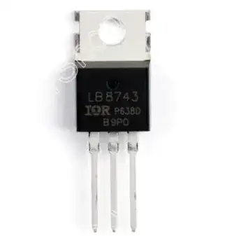

I am searching for the best solution for using a Raspberry Pi 3 to control a 24 Volt load at modest amperage.
It seems like the best choice is the IRL8743PBF because it can be switched to fully-conductive by a 3.3 Volt logic signal and can handle at least an amp of current flow without a heat sink. Plus it can plug into a breadboard.
Specifications Datasheet (PDF)
I've found that it can be purchased in 5-packs via the slow boat for $2.55 with free shipping HERE.
Question: Is there any reason not to use this one?

    I personally don't see any reason. This MOSFET has an on-resistance of 3.5mR which is an indication of low power dissipation and temperature rise for high (e.g. 5-10A range) load currents (\$\Delta T[°C]=I_L^2\cdot R_{ds}\cdot 62\$). – Rohat Kılıç Sep 23 '17 at 21:32
Judging from the IRL8743PBF datasheet you linked, you might be in for a bumpy ride if you drive them straight from a logic pin.
You say it "can be switched to fully-conductive by a 3.3 Volt logic signal", but that's not true. To get its rated 3.2mΩ, you have to use a 10V Vgs signal, see "Rdson" in the table on page 2. At 4.5V Vgs, you're guaranteed 4.2mΩ. There is no guarantee specified for 3.3V.
However, judging by fig.3, the current is about 5% at 3V, suggesting a 20-fold increase in Rdson (let's call it 100mΩ). Looking at fig.12, you can see the Rdson is off the charts for Vgs=3V.
You mentioned a load current of 1A. If my estimated ~100mΩ is correct, that's 100mW dissipated at 0.1V drop, which sounds perfectly reasonable, but all this is based on estimates from typical values. Not facts of worst-case values.
You're probably better off driving them from a higher gate drive voltage (4.5V will do. You can't use the 24V, too high), with a NPN transistor driven by the Raspi to shunt the gate to ground. See the circuit from this EE.SE answer from Majenko for an example:
NPN driving an N-MOSFET
Another concern with the choice is the maximum Vds voltage which, at 30V, is very close to your 24V. Any significant overvoltage spike (e.g. caused by inductive kickback) could kill the transistor. Be sure to protect against that (e.g. with clamping diodes).
Another warning: the "slow boat" option has a relatively high chance of giving you fake parts that don't quite deliver the promised specs. Better buy from a trusted source if you don't want that risk.

Which kind of load is the one you want to drive? Purely resistive or inductive? How much is the load rated? You speak about loading the mosfet at 1A that would give 24W. Yes the mosfet should be fully saturated at 3.3V Vgs. But it has an absolute maximum Vds of 30V. I would consider twice before using it in a real life application, such as a final product. With 24V load you are so close to the limit that a single spark or overvoltage could kill the mosfet. Why not going for a higher Vds version? My rule of thumb is always to choose components voltage rated at least 30% higher than required. Power considerations are more complicated because heat plays the big role here. Consider that "1Amp without heatsink" might be probably true, but is a statement that needs to be correctly supported by the application in which you are driving the mosfet. Mosfet's losses are related directly to their RdsOn, in this case very low, 3 mOhm. That gives you 3 mW (nothing). But what you dont take into account here is the switching losses. How are you going to drive the mosfet? Is that PWM? Which carrier frequency? This can considerably affect the performance of your system.
